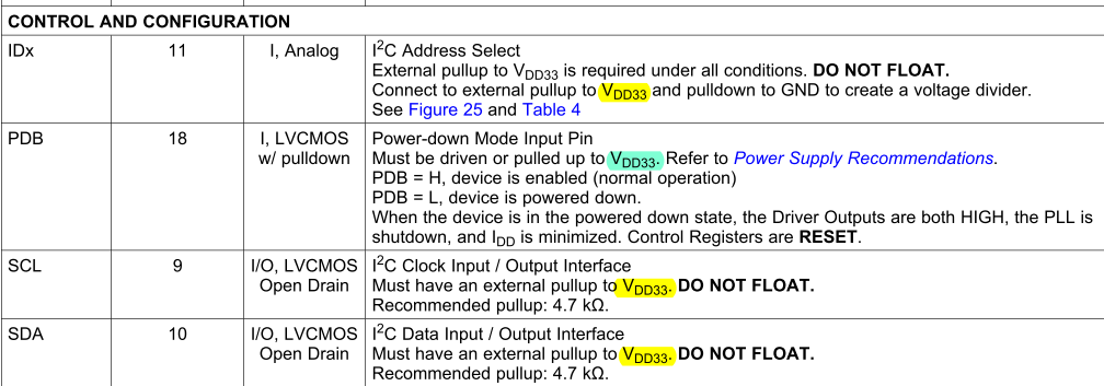

I would like you to confirm about below.
According to datasheet, there is following description.
In case of "PDB", I understood that specification of LVCMOS buffer of "PDB" is only 3.3V. so user need to drive by VDD33 or VDDIO(case of VDDIO=3.3V).
However, in case of pins which are related to I2C, I understood that user can use both 1.8V and 3.3V for I2C. So if user set VDDIO to 1.8V, then user need to pull up by 1.8V via pull-up resistor.
Is my understanding correct ?
(I'm not sure why TI described only 3.3V for I2C. (If user will set VDDIO to 3.3V, then user need to pull up 3.3V. In other words pulled up voltage depend on VDDIO....))
