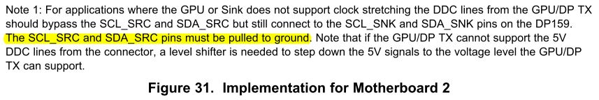

In the new revision datasheet (SLLSEJ2C), there is following highlighted note in Figure 31.

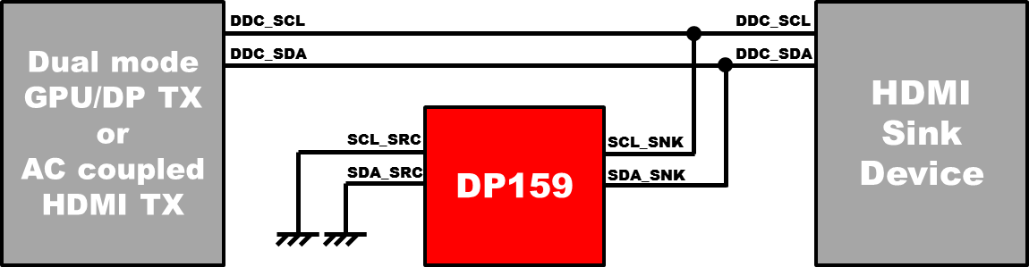

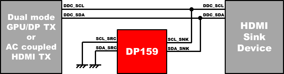

Would the recommended connection be the below, when clock stretching is not supported ?

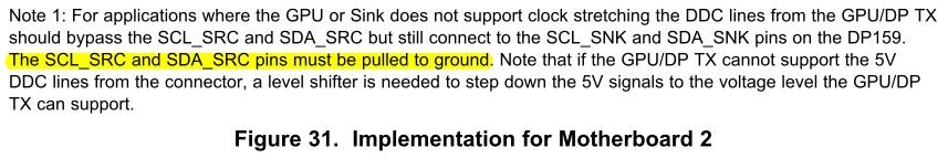

Hi Kawai-san,
You are right, that's how you connect DDC in snoop mode.
Something important to note is I2C high level voltage is 5V, if GPU doesn't support 5V you have to place an I2C level shifter.
Besides, take into account SDA/SCL_SNK still need 2k pullups.
