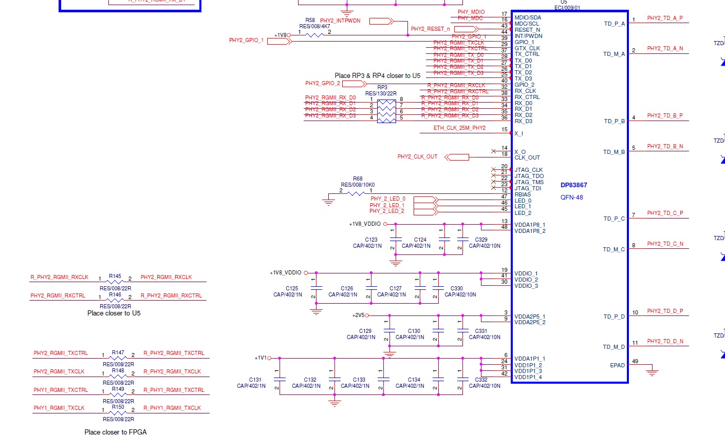

We have a new development with the DP83867 on board a module connected to an FPGA.
The link is up and fixed at 1G, full duplex
The transmit path from the FPGA -> PHY -> Computer works fine up to the data rate I tested on the desk (~8k packets/second)
However the rx path is unreliable. In the FPGA I receive a large number of RX_ER even at low rates (1 packet/s). Initially I had suspected that the RX clock delay was not being set correctly however regardless of the setting the RX_ER remains.
In addition and more importantly, I can poll the Receiver Error Counter Register (RECR), Address 0x0015 over the MDIO interface and I see the counter incrementing as I send packets. So this would suggest to me that the phy is seeing the errors even before the RGMII interface to the FPGA,
I have looked at a few of the other registers on the MDIO interface but I didn't see anything suspicious, however I may not be looking at the correct registers.
The datasheet does not document what would cause an error in the RECR register or why this would increment. Do you have any documentation about this.?
Is there any other registers I should read that might point to the source of the problem? Any thoughts or pointers would be helpful

    Register 0x01 is a LL register so you will need to do two reads to guarantee link status. Register 0x11 is not a LL. This might explain why you see variation on 0x01.
    Thank you for the information and great debug work.
    Nothing in the register dump you provided stands out besides the fact that the wires look to be crossed and there is inverted polarity detected, but the device will account for that and correct for error free operation.
    You should be seeing errors returned is the error is happening on the MDI. Since you are looping back before it is outputted on the MII, the issue could be with the connection between PHY and MAC.
    The data that you send to the PHY will still be visible on the RX pins with reverse loopback (unless you enabled the isolation bit).
    What i suggest is to place a scope probe on RX_CTRL along with RX_CLK. This will allow us to see if the error is appearing on the MII.
    What type of delay are you using? Internal delay within the PHY? MAC? or trace delay? You said that you tried playing with the ID but it had no effect? What setting are you using?

    If errors are occurring on the cable side, then I expect them to be returned to the computer when doing reverse loopback.
    Can you enable the MII or digital loopback and send packets from the FPGA and return them back to it?
    This will help in the debug. Also, please send me your schematic for review. I only need the 867 and passives around it.

    I'm doing some loopback tests at the moment and will update the thread when I get it. In the mean time this is the instance of the PHY
    I noticed the resistors on the RX pins which I am currently getting changed to 0R. I'd welcome any comments about the schematic !

    I don't want to distract you from the debug path Ross has taken you on but I want to see if you can answer a few quick questions on your initial setup.
    What kind of computer are you using? What model of NIC is in the PC the 867 is attached to?
    Can you try writing 0x170 to register 0x31 and see if this clears up your RX_ER issues?

    I tried that write to the register and it definately has an impact on the RX_ER count in the reverse loopback mode. I need to quantify during the day. What exactly have I changed? According to the datasheet the bits are reserved?
    Diarmuid
  • Diarmuid,
    We have seen conflicts with certain Intel NICs, and even some switches, that is related to auto-negotiation. The HW solution is strapping the RX_CTRL pin to mode 3.
    The before mentioned register configuration affects a timer that we'd otherwise like to be untouched, hence reserved. This is only necessary if RX_CTRL is not in mode 3. Please set this value into the register before auto-negotiation takes place.
    This is slated to be updated in the DP83867 DS revision.
