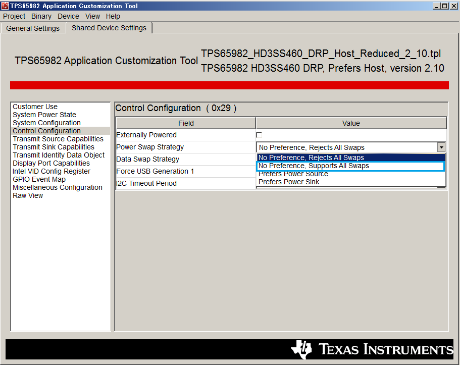

Hi Team,
I set "No Preference, Supports All Swaps" in Power Swap Strategy as the following and save the project.
Then I load the project, however I couldn't load a project that reflect above.
It seems other setting like "Prefers Power Source" or "Prefers Power Sink" are no ploblem to be load.
Could you support on this issue?
Yaita / Japan disty
  • Yaita San, It seems like an issue w/ the template - We've made a note of it, and shall fix it in the upcoming release of the tool. Meanwhile, you can use the following fields/mapping from the corresponding *_full_* template:
    • No Preference, Rejects All Swaps = Process Swap To Sink:0, Initiate Swap To Sink:0, Process Swap To Source:0, Initiate Swap To Source:0
    • No Preference, Supports All Swaps = Process Swap To Sink:1, Initiate Swap To Sink:0, Process Swap To Source:1, Initiate Swap To Source:0
    • Prefers Power Source = Process Swap To Sink:0, Initiate Swap To Sink:0, Process Swap To Source:1, Initiate Swap To Source:1
    • Prefers Power Sink = Process Swap To Sink:1, Initiate Swap To Sink:1, Process Swap To Source:0, Initiate Swap To Source:0
