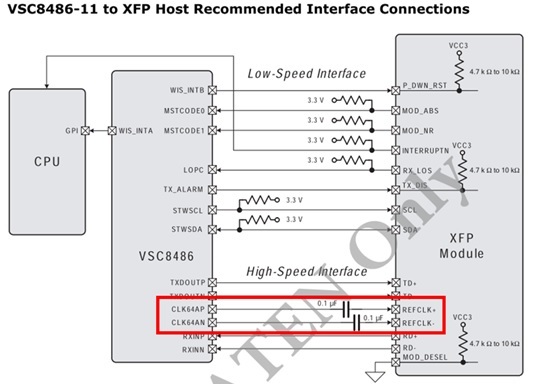

Dear Sir
Does TLK10031 have ??
1. Reference design schematic
2. Application note or design guide
3. TLK10031's CLKOUTAP/N can connect with  XFP module REFCLK ??
  • Hi Kai,
    1. For reference design we suggest to take the TLL10232EVM since is the evaluation module board for TLK10xxx family, basically the TLK10031 is the single channel version of the TLK10232/034.
    www.ti.com/.../TLK10232EVM
    2. For application note or design guide please take a look into this list:
    www.ti.com/.../analogtechdoc_hh.tsp
    There are several application notes for high speed links using the TLK10xxx family.
    3. Yes you can connect the CLKOUTAP/N to REFCLK in the XFP module as long as the specs are into the valid ranges.
    I hope this helps.
