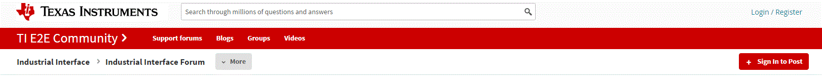

  • Hello Nader,
    There is a button at the top right of the forum that you can click to add a new post (where it says "+ Sign in to Post":
