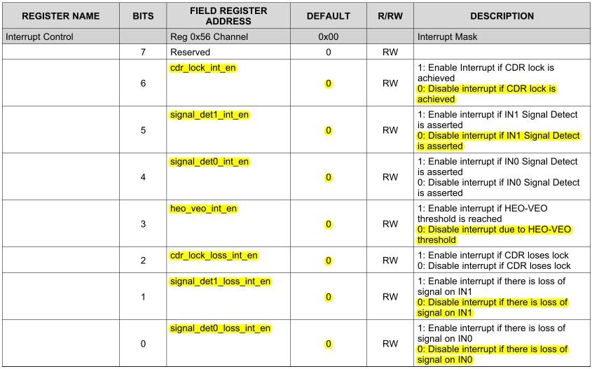

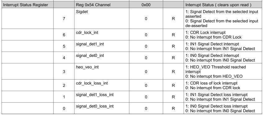

Hello Team,
Please allow me to ask you about LMH1218 status register.
Q1) Is LMH1218 interrupt status register function disabled by default ? It seems you need to set REG 0x56 bits to use this function. Is my recognition correct ?
Q2) Is this function disabled by default to decrease power consumption ? If YES, how much power (current consumption) is different when these function enabled or disabled ?
Kawai
