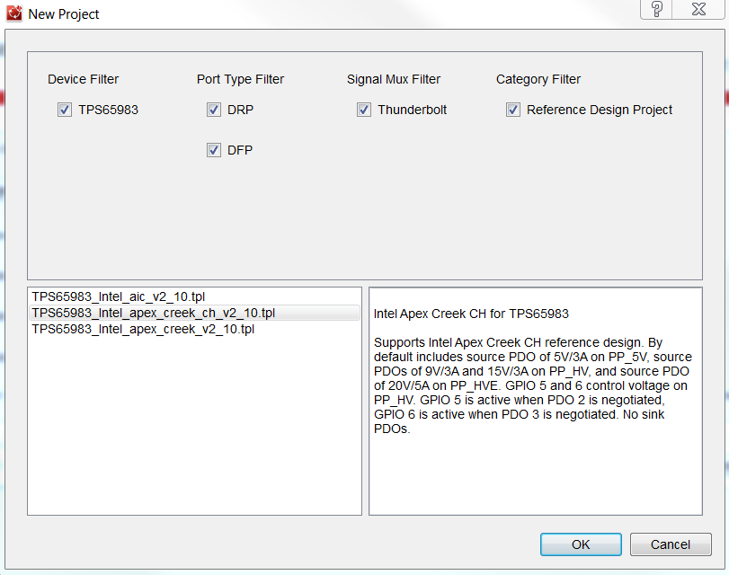

Hi Sir,
Could below GPIO setting in Application Customization tool work normally?
My customer measure the GPIO 5 and 6 ,but they didn't work.
Thank you
