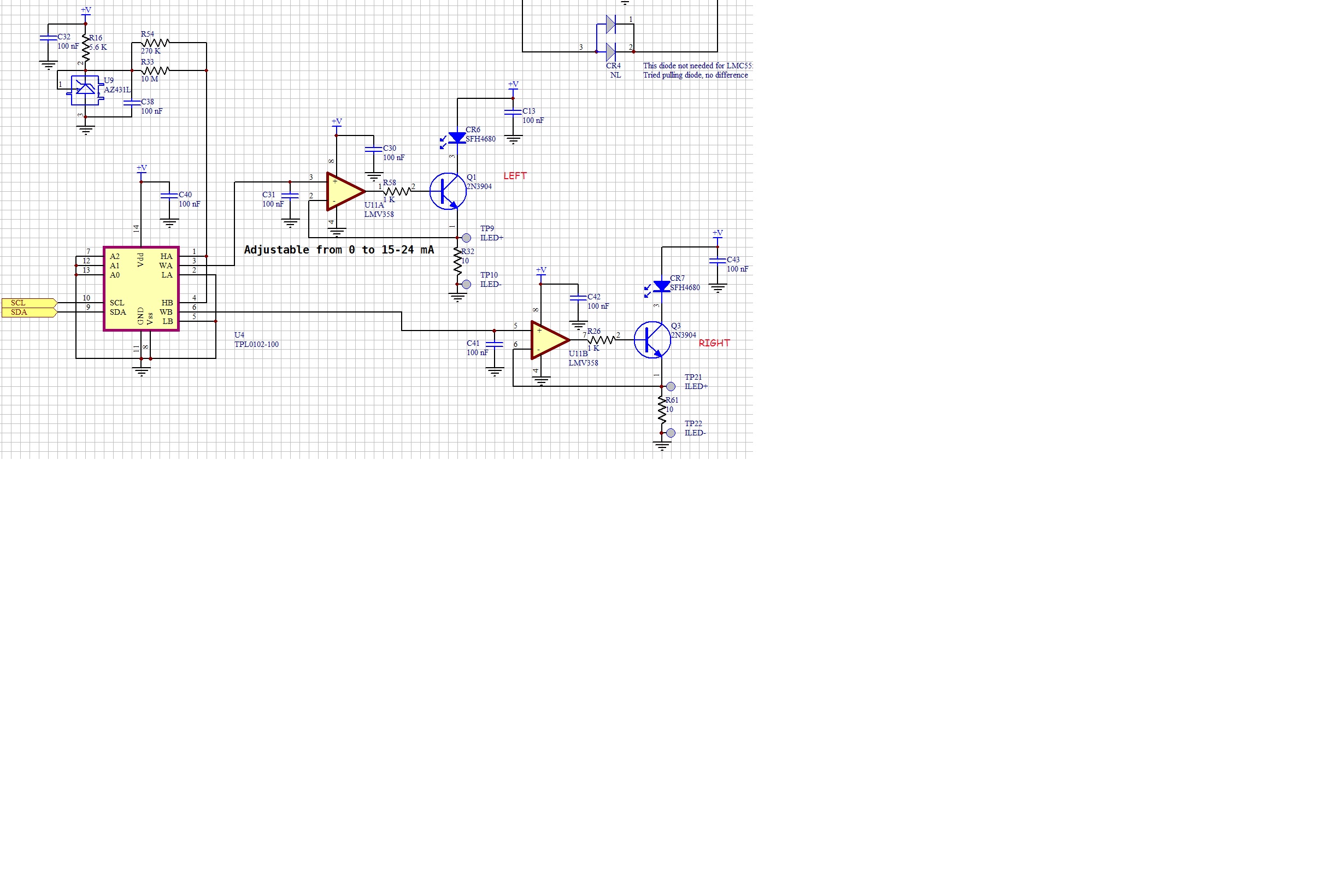

I am using the TPL0102-100 in two identical circuits as potentiometers to provide a command voltage to two identical current sinks.  There are two of these circuits on each PCB (two TPL0102 ICs controlling four current sinks).
Briefly: the system runs on 4.5-5V.  The HA & HB pins are driven from the output of a voltage reference at 1.25V.  The LA & LB pins are ground and the wipers are connected to the non-inverting inputs of LMV358s.  The LMV358's are configured as current sinks driving the base of 2N3904 BJTs through a 1K resistor.  The emitters of the 3904's are connected to ground through 10 ohm resistors and to the inverting side of the LMV358s.  There are 100 nF capacitors on each wiper.  The supplies, op-amps and TPL0102s are properly bypassed with 10 uF and several 100 nF ceramics.

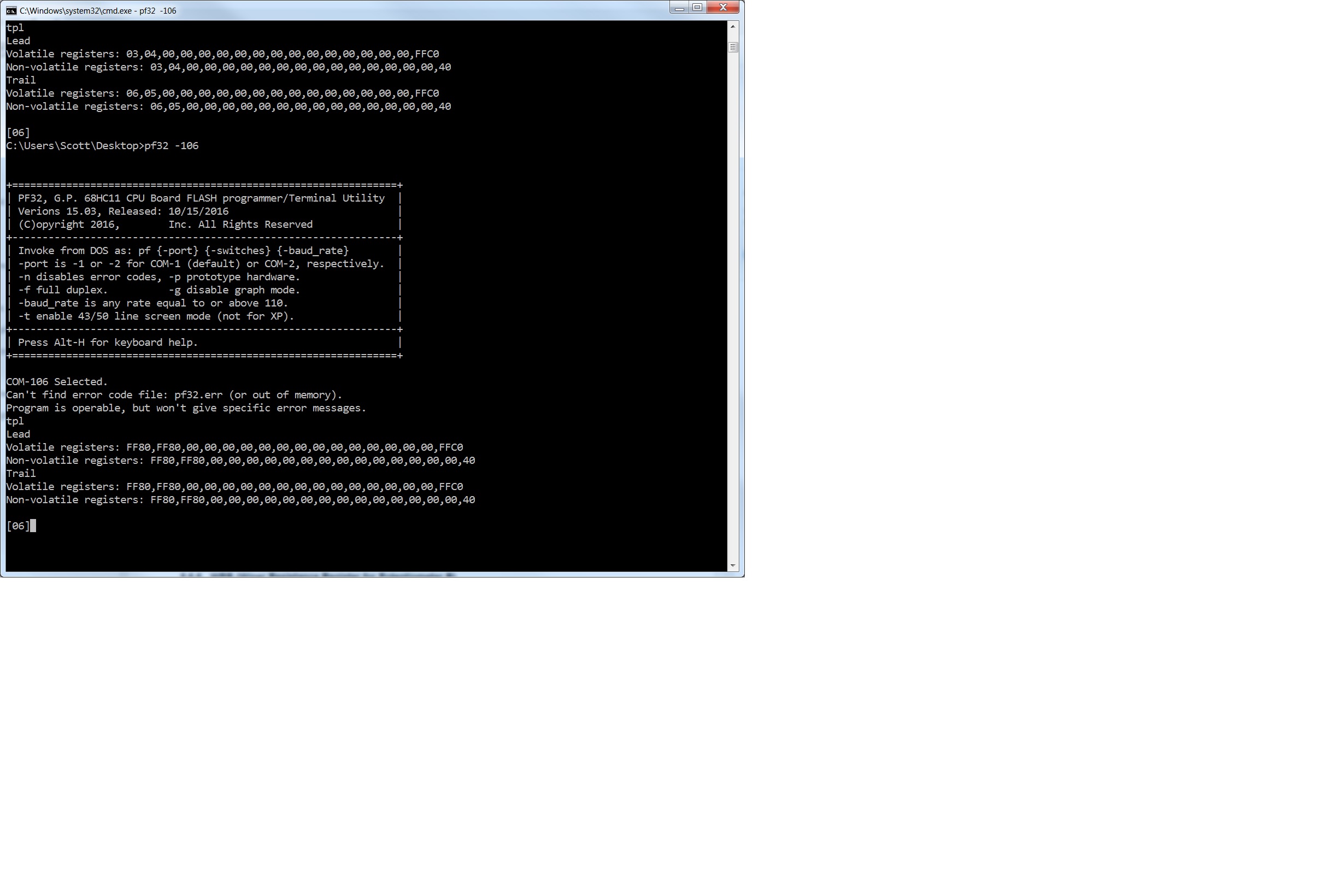

I am able to program the pot resistance and the load current follows the pot settings.  The test program allows me to adjust the volatile pot settings, then on command, copy the values into EEPROM for non-volatile storage.  I am displaying both the volatile and non-volatile registers and see both sets of registers are properly set.  After I set them (permanently), I disconnect power for several seconds and reapply power.  Both the A&B pots on both chips have returned to their default values 0x80.  One chip is strapped for address 0 the other for address 1.  I am controlling the pots with their I2C interface.  Both pins 1 & 8 are grounded.  The entire system (pot, opamp, I2C controller runs on the same power-supply, although there is a 10 ohm sampling resistor between the I2C controller supply and the TPLs.  The is less than a 1/2V difference between the supply levels and usually less than 200 mV.  Do you think the supply differential could be causing the issue?

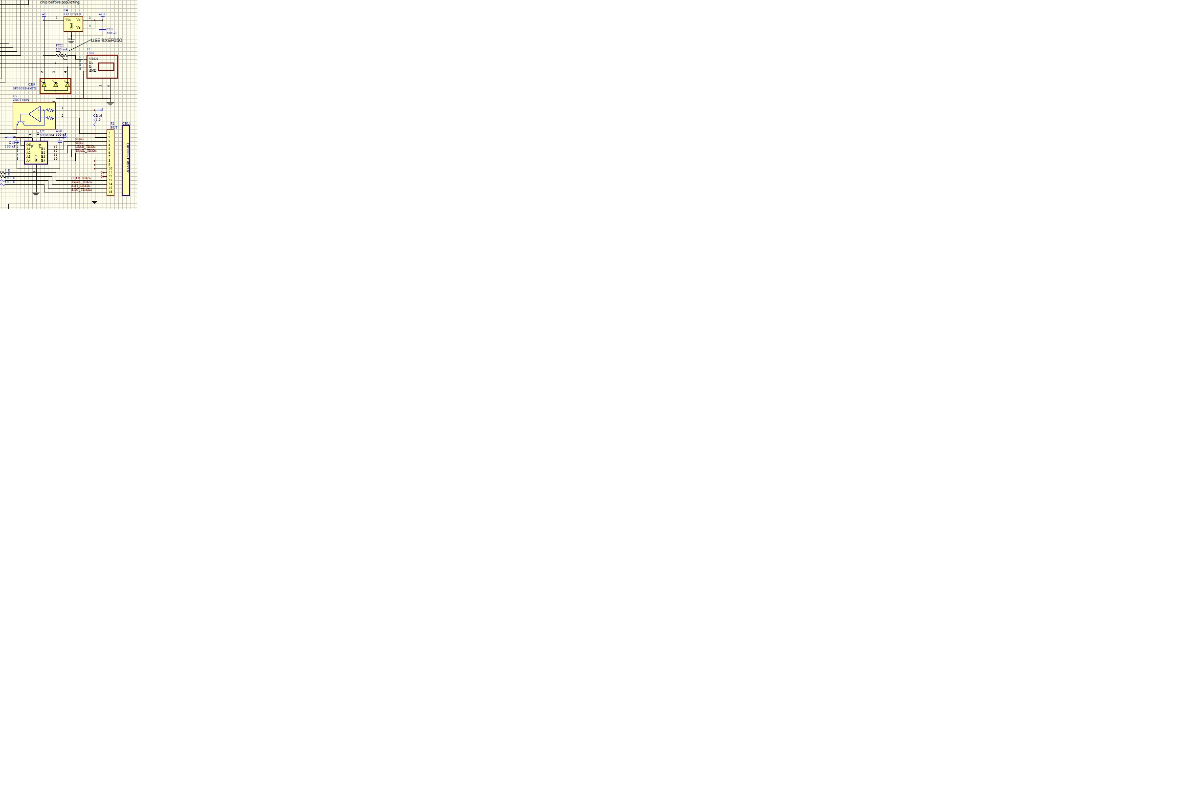

    If you have a schematic or diagram that would also be helpful.  I am not sure I understand how your are connecting supplies for I2C controller and TPL's?

    I've attached a couple of schematic fragments and a script before and after power is cycled showing the default values instead of those programmed into the pots.  ckt shows the TPL pots and the current loads they control, ckt1 shows the system, a tester PCB, that supplies power to ckt via pins 1 & 2 of connector P2.  So you see I power the device from the USB supply, and place a 1 ohm (R16) along with U5 to sample the PCB current.  Typically the PCB draws 50 mA or so.  Originally, R16 was 10 ohms and I was concerned that the supply voltage on the TPL (U4) was 1/2V lower than the I2C signals and this was causing the resetting issue.  I had a chance to check that out this evening by lowering R16 to 1 ohm thus reducing the drop to around 50 mV below the I2C high levels.  This made no difference to the TPL0102 losing its settings.
    I have an interactive mode that allows a user to adjust the LED current based on illumination measured elsewhere.  The user selects one of the four LEDs and adjusts it while monitoring its emitted light level and the total board current.  During this time, the VOL bit is high to access the volatile pot settings.  Once all LEDs are adjusted, another command copies the settings into the TPL's EEPROM.  The VOL bit is set low during this operation.  I have another command that first sets VOL high and reads and prints all 17 registers, then it sets VOL low and reads all 17 registers again.  This is repeated for both TPL0102 pots on the PCB.  After LEDs are adjusted, and the setting are saved in EEPROM, both sets of registers are equal to the values the user selected during adjustment.  I can repeat the display indefinitely and see the same values.  After a cycle power (unplug USB, wait several seconds then replug), I see the displayed values have all returned to 0x80 for both wipers (address 0 and 1) of both pots.  The -SHDN bit is always high, I never put the pots into low current mode.  When programming EEPROM in the pots, I monitor WIP in the ACR register to prevent writing values before EEPROM programming is complete.

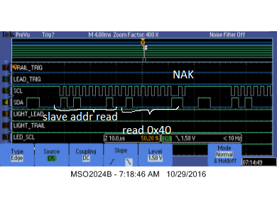

  • Hi Francis,
    I hooked up the logic analyzer to verify the I2C bus transactions.  All the transactions look OK, except the pot is not reporting busy when I write to a non-volatile register then read the ACR immediately afterward.  That's the only strange thing I see.

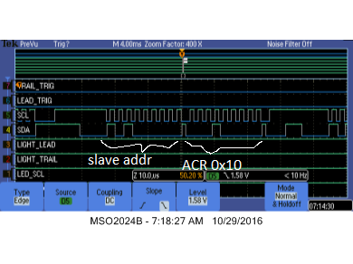

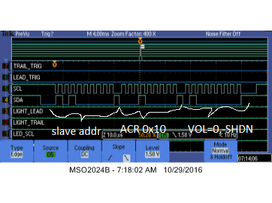

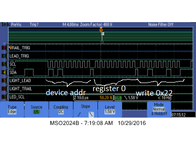

  • Hi Jonathan,
    I've attached 6 images showing the steps I used to write 0x22 to address 0 with VOL=0.
    I have two parts, presumably from a different batch, arriving tomorrow. I'll swap them out. I have two boards each of which contain two TPL0102-100 parts. Both give the same result.

    I just verified that if write to ACR-Access Crontrol Register address ( 0x10h) with C0 (VOL=1, SHDN=1, WIP=0, bit4-0=0) then write to either IVRA (0x00h) or IVRB (0x01h) with desired  wiper location that once I power down it gets stored into the non-volatile memory.  I think you are writing the wrong hex value to ACR register.  Please try this out and let me know if this fixes your problem.
    -Francis Houde
  • Hi Francis,
    Your last post contradicts the data sheet.  You said you wrote VOL=1 and the pot recalls your written value on the next cycling of power.  But the data sheet says VOL must be LOW to permanently save a value written to address 0 or 1.  Which is it?
    Also, from the displays I posted earlier, you can see I wrote 0x22 to register 0 with VOL set to zero (as confirmed with a read-after-write check).  When I cycle power and read back the register I read 0x80, the pot's default value.  Furthermore, the pot's resistances are approximately equal between the wiper and the H and L terminals confirming it is indeed set to 0x80.
