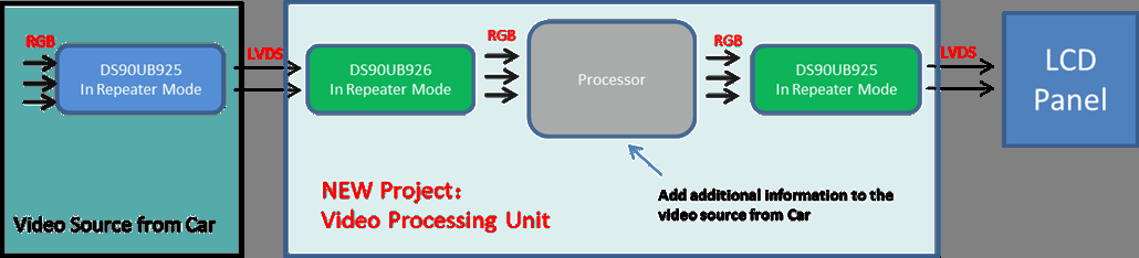

I encounter a problem about DS90UB925 and DS90UB926. Could you kindly give me some advise?
My block diagram as follow. There is a DS90UB926 on my board, which get data stream from DS90UB925 from the car.
But the system doesn't work well. The Lock pin of 926 only got high for about 300ms when power up, then it got low, and the RGB pins have no output. The wave form of VDD(channel 1)and Lock PIN of 926(Channel 2) as follow:

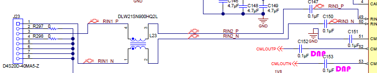

6、On the reference design I see a CM inductor and resistor on the line, which I don't have in my design ,is it important?
my design
reference design
