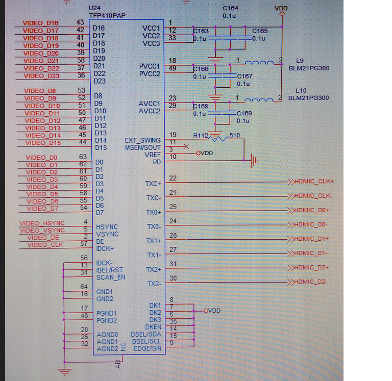

The customer is using TFP410. The attachment is his schematic. The input signals of TFP410 is provided for FPGA. But there is not any output signal in his circuit
even if PD is connected to VDD. VDD is 3.3V.
What is the reason? How to solve the issue?
