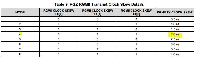

I've got a question about the strap configuration of the Rx/Tx clock skew. We have chosen Mode 4 according the DP83867 DS (www.ti.com/.../dp83867ir.pdf) and expected a delay of 2.0 ns:
According the Application Report SNLA243 (www.ti.com/.../snla243.pdf) Table 5 on page 7 there is a table that contradicts the information in the data sheet. According this document Mode 1 corresponds to 2.0ns skew:
Which table is correct ?

    Which device are you using? The IRRGZ or IRPAP? IRRGZ I hope as IRPAP does not support strapping RGMII delays.
    The application report table is correct and the table in the DS will be updated.

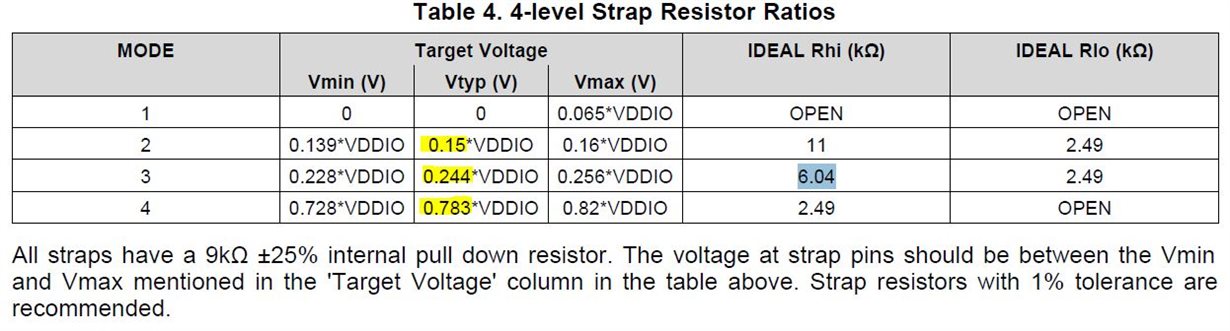

    The problem with the strap pins in my application is, that I have connected some of them (RGMII interface) to an FPGA and there are weak pull-up resistors in the FPGA that I can't turn off. That's why I can't leave the strap pins 'open'. When I avoid strap mode 1, the impact of these pull-up resistors should not be too strong, but because I don't know the tolerance of these resistors it's hard say what strap voltage will result for the strap modes 2,3 and 4.
    In the datasheet I have found the following information:
    My question is now: What is Vmin and Vmax? Is this the resulting strap voltage because of the internal 25% tolerance resistor OR is this the specification of the strap voltage that must be fulfilled to be sure that the corresponding mode is selected? Can you give me additional information what happens when the strap voltage is between 0.065*Vdd and 0.139*Vdd or between 0.16*Vdd and 0.228*Vdd or between 0.256 and 0.728 or above 0.82*Vdd?

    Vmin and Vmax are the threshold voltages required to enter the strap mode. Vmin and Vmax does not take into account the resistors. If you force this voltage on the pin, the strap will enter that mode.
    There is indeterminate behavior when you enter the voltage guard bands between strap modes. The exception to this is that above 0.82*VDDIO, you will always enter mode 4 because there is no strap level above it.
