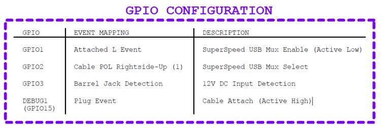

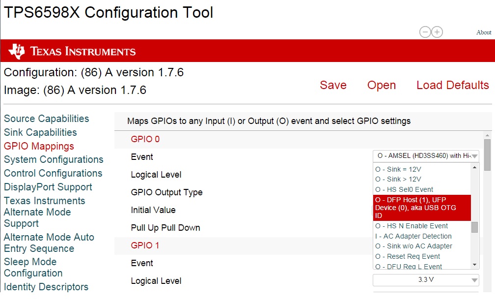

My customer is following our reference design TIDA-00882 for USB Type-C HDD with USB power delivery using TPS65982.
1) Which mapped event is selected for GPIO1 that is connected to SS_MUX_EN# of OEN pin in HD3SS3212?
2) Which mapped event is selected for GPIO2 that is connected to POL of SEL pin in HD3SS3212?
