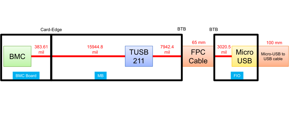

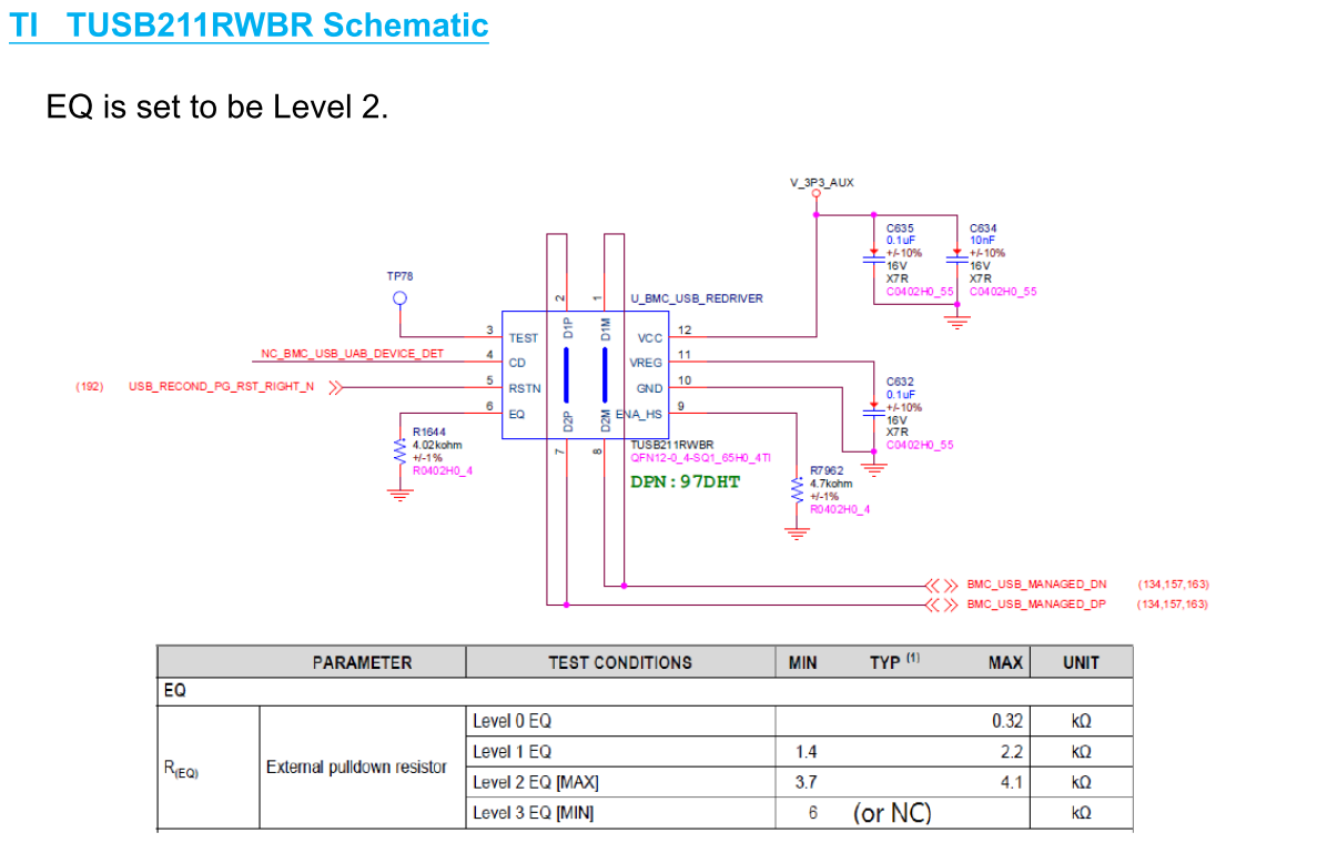

Customer use TUSB211 but eye diagram test fail. Below is topology and schematics. Do you have any suggestion to pass eye diagram? Thank you.

Hello Patrick
That's correct, but customer rather increase the differential output amplitude first (if it is possible).
Diego.
