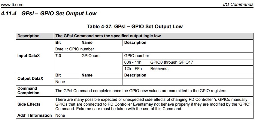

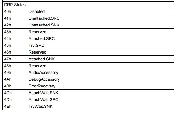

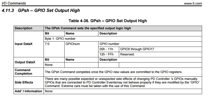

is it possible to have a dedicated GPIO for doing role detection? I have no experience with these devices and I would like to check with you if what I am thinking makes any sense:
By looking at byte 4 of the 0x69 C_CCn Pin State Register one can recognize the role of the Device like so:
If we have 44h or 47h then we would need to do either of the following 2 things:
Is this all you would need to do? Am I missing anything? Or am I completely wrong.
