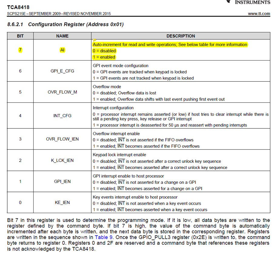

I'm working on TCA8418 right now.
2 Bytes writing is working but I cannot write more than 2 Bytes.
When I'm trying to read more than 2 bytes it is working.
Can you help me is it possible to wirte more than 2 bytes?
