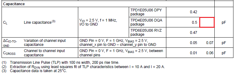

Hi Team,
Do you have max value of line capacitance under Ta=25℃ for TPD4E05U06DQAR?
The background of the question is my customer is checking a difference of the parameter between TPD4E05U06DQAR and PUSB3F96(NXP).
Yaita / Japan disty
  • While we cannot guarantee any maximum value for the line capacitance, tests on a similar part have shown a maximum line capacitance of around .65pF.
