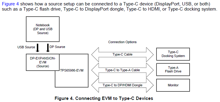

I am evaluating TPS65986EVM + DP-EXPANSION-EVM with some Type-C devices in the marketplace.

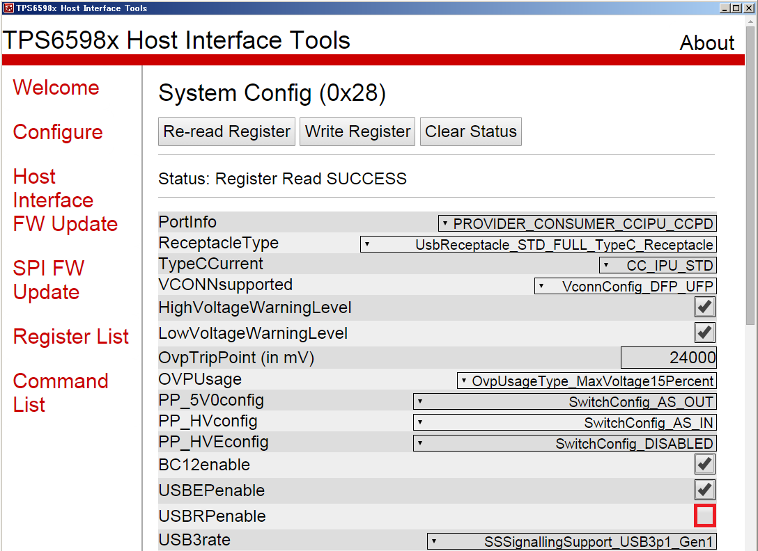

I found USB mouse that is connected U3HC-DC03BBK (ELECOM) can't be recognized (not found) in PC unless USB RP path is disabled as the following.
*U3HC-DC03BBK is powered by its charging port in this case.
May I have an advice why USBRPenable should be disabled in this case?
