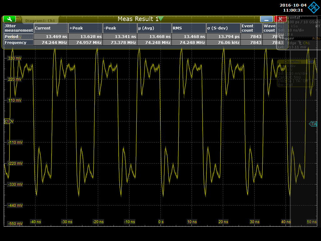

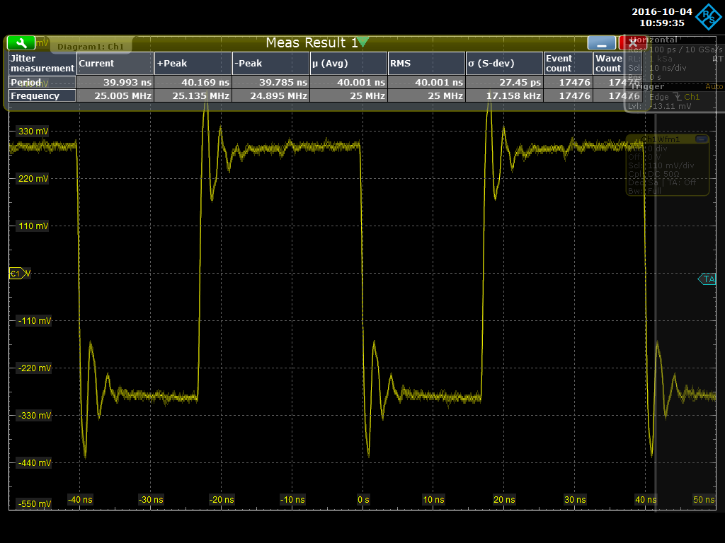

On both the ‘928q-q1 and the ‘927q-q1 the LFMODE = 0 (GND). A measurement of the differential input PCLK can be seen in the attached pictures. As example we have chosen 25MHz and 74.25MHz. With 25MHz the link is constant, with 74.25MHz there isn’t a link. The border we’ve mentioned is 42.5MHz, frequencies below were working fine, with bigger frequencies on PCLK no link becomes ready.

    There are two main areas that I would recommend to check in this case - the input PCLK signal integrity, and the FPD-Link III channel characteristics.
    The PCLK input has a lot of ringing, so it may be that the 927 is having trouble detecting a stable frequency. Have them repeatedly poll 0x0C to see whether bit 2, PCLK detect, is toggling. Also check to make sure there is 100 Ohm termination on each input OLDI pair.

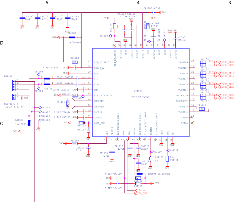

    It's also always a good idea to get the schematic to make sure they're not doing anything obviously wrong. Compare it with the datasheet typical connection diagram and ask us about anything unusual.

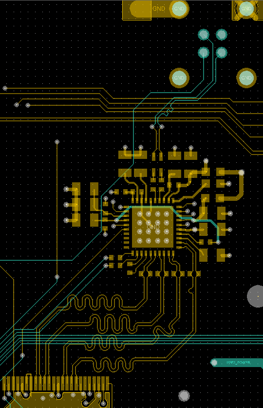

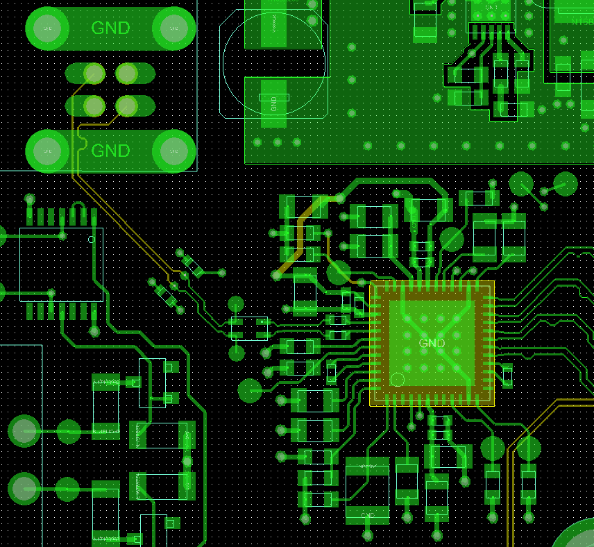

    For chehcking Layout and Schematic:
    This is the serializer side:
    This is the deserializer side:
