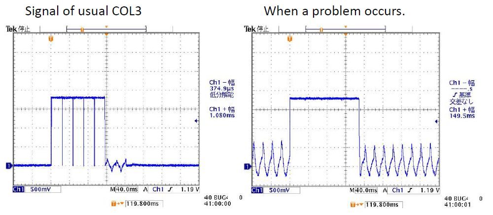

COL3 output wave form:

    I need to get some additional information about this application and I need to get more details about what your are doing.  What I see on the scope plots looks very concerning.  What is causing the triangle saw tooth part of the waveform?
    How are you implementing the 10,000 key stroke?  What are the reads and writes you are sending during the testing? If you have code then please send that along too.    I have not seen this waveform before. I would like to understand where it is coming from.  Even the first one has the problem but is less severe and then stabilizes.

    When they confirmed the symptom,
    they found out COL3 was in the state of HiZ, and a triangle waveform appears on the oscilloscope at the state that a finger touches other keys with which COL3 is shared. (The key of a shape is a dome type and is not pushed down.)
    When a finger was separated from the state which touching a key, COL3 become to be low.
    During the idle key scan mode, all COLs are low, aren't these?
    When the error occurs, it seems the COLs are the HiZ state.
    Is there anything for the condition that COLx will be in the state of Hiz?

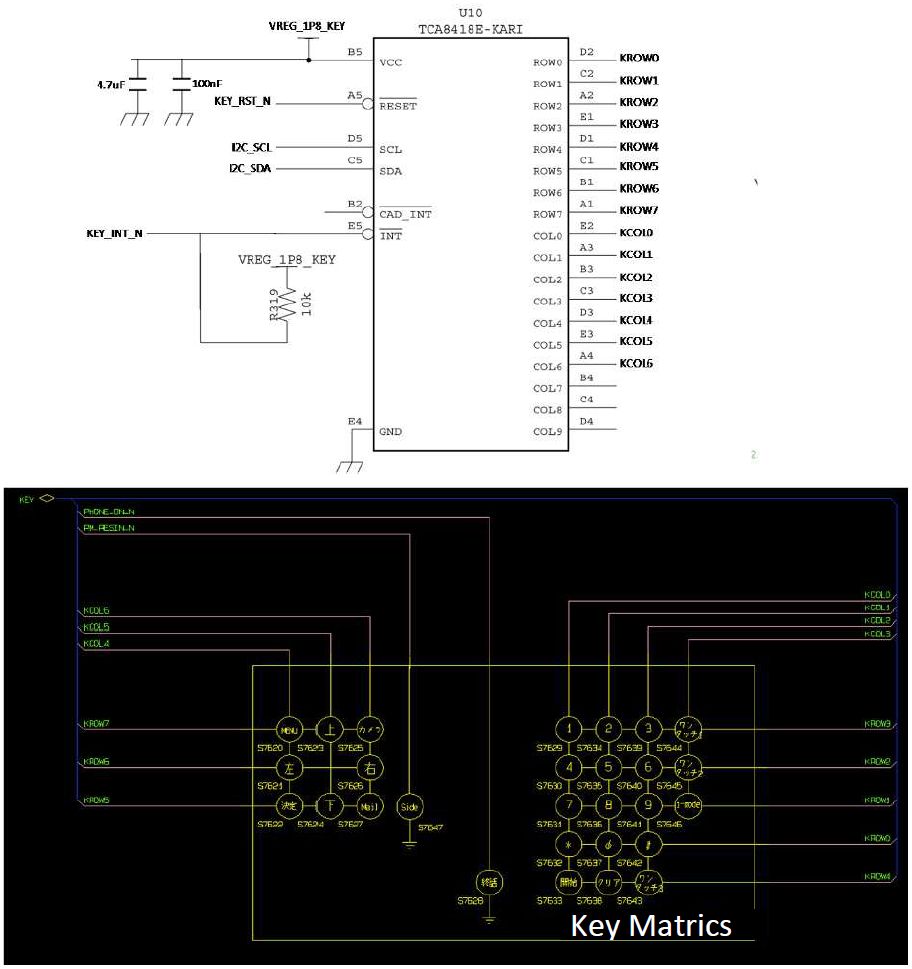

    Anyway, I have received the schematics from my customer as below.

    1) During idle key scan mode, all COLs are low? YES, when all keys are idle/not pressed and voltage all rows is high, the TCA8418E will put all COLs into output low mode. During the key scanning process (1 or more keys is being pressed), the TCA8418 will sweep through all COLs by having all but 1 COL be high-Z.
    2) Should unused COL or ROW pins be tied to VCC through an external pull up resistor?  YES, it would be best to use a 10k or 100k pull-up to VCC on unused pins.
    Note about your waveform: COL3, the triangle waveform you note is from when a user touches another key that COL3 shares. Since COL3 is floating in this instance, this might not be a huge concern, because COL is not supposed to be held to any specific voltage, and is not an input. However, it does seem to suggest that you might want to consider some way to prevent a user from touching the actual signal path, creating this noise.
    One thing to try, since this issue seems to be a result of noise getting coupled onto the COL pins during a sweep, I ask that the customer try a pull-up resistor on the COL pins to assist in eliminating noise. I suggest trying a 100k pull-up resistor on each COL pin. By doing this, ICC will increase, but it should help get rid of the noise coupling issue we are seeing.
    The best solution I think is to better isolate the noise from the signal lines, but I think using a 100k pull-up resistor (or 50k) on each COL pin to VCC should help.
