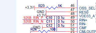

My customer's board use a DS90UB926, but it can't lock with the DS90UB925 on the other board.
After comparing between reference design and the customer's board I found some difference.

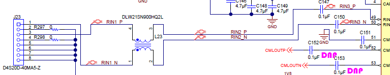

On the reference design I see a CM inductor and resistor on the line, which I don't have in my design ,is it important?
Customer's board.
Reference design
