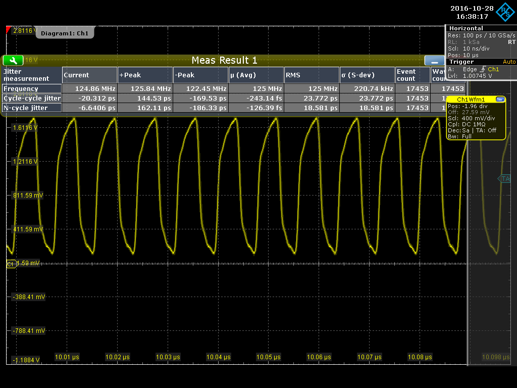

  • Hi
    I have verified that the issue is also exist on another board, so it is unfortunately not just a single device defect.
    I have measured the jitter on the output clock from the PHY. Thereby I can measure the reference clock that the PHY see.
    The 25Mhz clock out of the PHY has a Cycle-Cycle jitter RMS jitter of 34 ps and N-cycle jitter RMS jitter of 23 ps, see plot below.
    I have also measured the receive clock for Channel A and I can’t see any issue with the receive clock. A plot of the measurement is bewlo .
    I tried to measure the error rate with difference frame size, see list below.
    Notice the pattern in the frame size where I see the issue:
    - 65 Byte frames bit error rate  3.0 x 10^-9
    - 73 Byte frames bit error rate  2.2 x 10^-9
    - 81 Byte frames bit error rate  3.6 x 10^-9
    - 89 Byte frames bit error rate  3.0 x 10^-9
    - 97 Byte frames No error
    Regards Sune
  • Hi Sune,
    As per your scope pictures the oscillator frequency is 25.02MHz which violates the +/-50ppm requirement on the clock. Will it be possible for you to share the schematics so that we can have a closer look?
    -Regards,
    Aniruddha

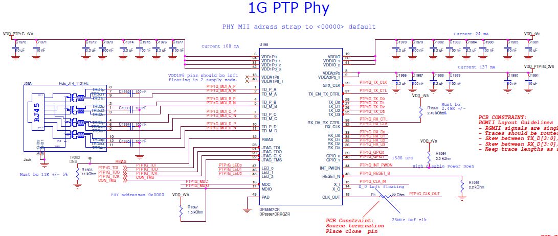

  • Hi Aniruddha
    I agree the PHY can operat with 100% utilization just the IPG is not under 12 byte.
    Please try a test with just two 65 byte frames and a IPG between the frames of 10 to 8 byte.
    I have attached the schematic part with the DP83867CR , but I see the schematic as irrelevant as I see the same issue on the TI evaluation module DP83867IRPAP-EVM.
    Regards Sune
  • Have you reproduced the issue with two 65 byte frames and a IPG between the two frames of 8 byte?
  • Hi Sune,
    We are working on a way to generate this. We do not have test equipment readily available that can generate IPG less than 12 bytes.
