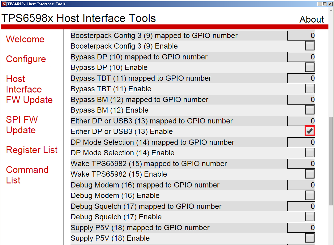

I am evaluating TPS65986EVM + DP-EXPANSION-EVM for evaluating alternate modes.
It seems GPIO configuration register can't be written correctly by TPS6598x Host Interface Utility Tools.
For example, actual GPIO that is assigned "Either DP or USB Event" is still high although I disabled "Either DP or USB3 Enable".
Could you confirm the issue?

  • Hi Jacob-san,
    I cleared the check box of "Either DP or USB Event (GPIO#0)" by utility tool while Type-C device that supports alternate mode is connected, then I found GPIO#0 shows still high.
    However I disconnected Type-C device and cleared the check box of "Either DP or USB Event", GPIO#0 is disabled correctly. (GPIO#0 shows still low when I connect the Type-C device in this case.)

  • Hi Yiata-san,
    Thank you for your patience. One thing, could you confirm that you are setting the GPIO low? Although the event has been disabled the GPIO will continue to be driven high until there is some change that occurs (like a disconnection).
    Did you say about initial value of GPIO#0?
    If the answer is yes, I set "low" for initial value of GPIO#0 in application customization tool.
