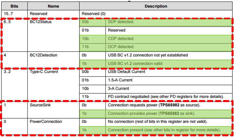

I'm trying to read some registers over i2c on the tps 65982 evm working as a sink. When i plug an external charger to the TPS i perform a reading of the registers.
and I’m having some issues while reading the registers (0x3F) through i2c. I manage to read them, but there is one part of the byte which contains information about the BC12 Status which I don’t really understand…
According to what is sent on the I2c bus:
- BC12Detection=1;
So I should obtain in BC12Status a 00,10, or a 11 is it right? Is it mandatory to have one of these modes when BC12Detection is 1?
Instead of that I receive a 01 which means “Reserved”. What does it actually mean?
I also have another question about anotehr register: when i plug a charger i have the CCPullup at two (10) (1.5A) first, then after  couple of seconds it turns to 1 (01) (Default usb current). Why does that happen, is it because of the chargers negotiation?

    Could you verify that the the TPS6598x is a sink?
    The Type-C current advertisement will depend on what it the DFP (Source of VBUS). If you are connecting a BC1.2 charger with a Type-A to Type-C cable, the cable will have a default current setting since it is a legacy USB Type-A port.
    Jacob
  • Nop I wasn't since I didn't have the aardvark adapter, i was using my home-made solution with an msp430 ;) Now it works fine, it was just a bad mask XD
