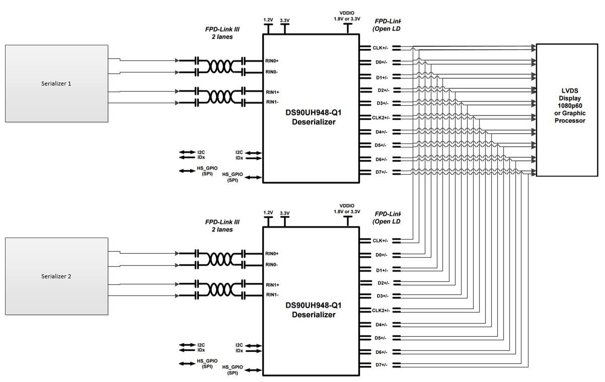

I am routing two DS90UH948-Q1 deserializers into one 1080p screen as such:
For this setup, I have a couple of questions:
1. When I have one 948 with its output disabled and the other 948 with its output enabled, I am seeking to understand how the signals from the 948 will interact with the 948 that has its outputs disabled? Do the disabled outputs becomes high-impedance? Is it possible the signals coming out of the enabled 948 can run into the pins of the disabled 948?
2. Is it required to have a switch or MUX to implement this setup, or can I wire the setup as shown above with no switch or MUX? Obviously the routing will have to be much different than what is shown above, but from a conceptual standpoint, is there a risk associated with doing what I have shown above?
Thank you,
Jared

  • HI Jared,
    For question #1: The signals from the disabled 948 become a high-impedance state so it will not back drive the disabled 948.
    For question #2: There will be a stub hanging off of the "top" 948 OLDI outputs when it is transmitting when the "bottom" 948 is disabled.
    Ideal scenario would be to use a switch or mux if not you will get more OLDI eye closure with the scenario you are showing above.
