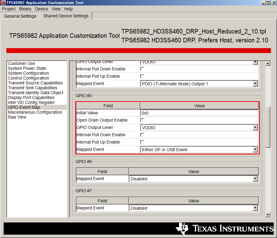

Hi Team,
My customer is designing TPS65982 + HD3SS460 for a tablet application that supports Alternate Mode.
He assigned GPIO#3 for EN pin of HD3SS460 as the following.
Under above GPIO#3 configuration, I concern USB SS line are still disabled when connecting USB3.0 device that doesn't support Power Delivery (Alternate Mode).
So I believe I should configure GPIO#3 to high state in default.
How to configure GPIO#3 in this case?
