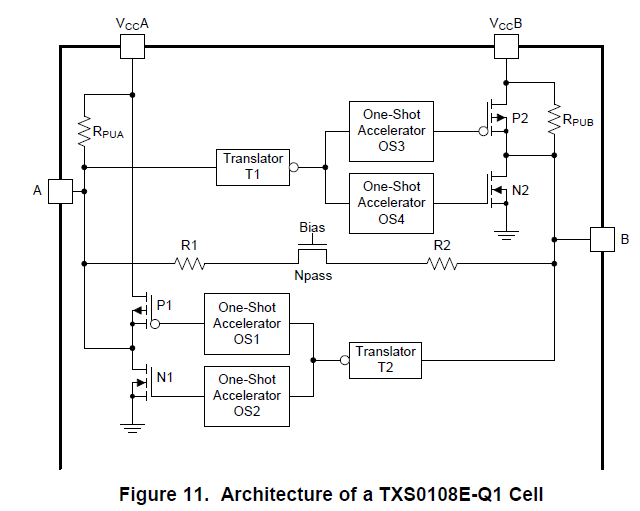

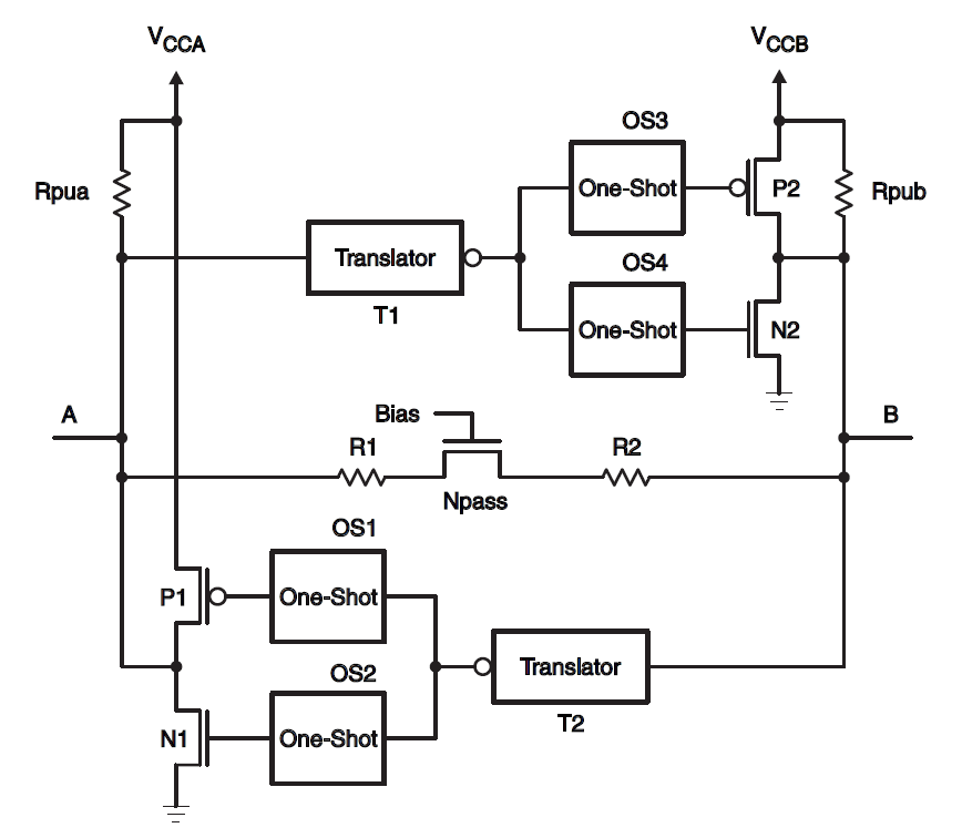

  • Hello Shu-Cheng,
    Rise time accelerators (RTAs) or sometimes called edge rate accelerators are used in a lot of parts, such as the TXS family of translators/level shifters.  I like to think of it as a FET across the pull up resistor that gets turned on to reduce the pull up resistance during turn on, which makes for faster transitions.  Here is an image of a part that used rise tire accelerators.
    I hope that this is helpful in explains what a RTA is and how it works.
