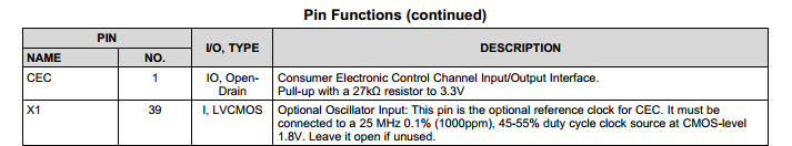

1、cec function is not needed,cec pin folat is OK?

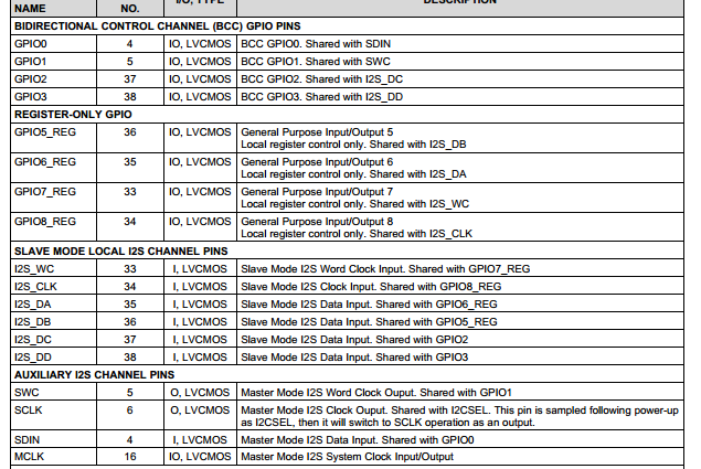

2、Could you help introduce the D_GPIO configuration?If you do,pls describe the way in detail.

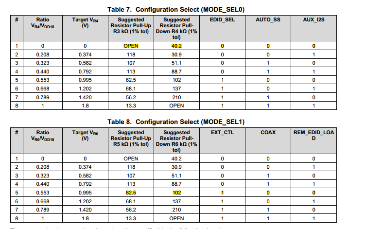

3、mode_sel configure as follow is OK?

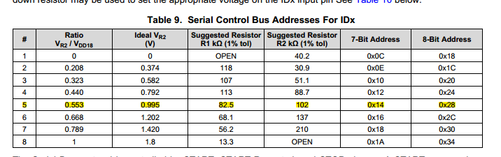

4. the I2C address is configured to 0x28,IDx configuration as follow is OK?

7.I2S is not needed,the I2S pins float is OK?
