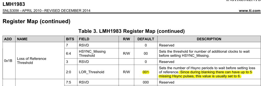

Hi Team,
Could you please allow me to clarify the Loss of Reference Threshold register ?
In the datasheet register description below, LOR_Threshold is recommended to set to "6", however, the default value is "1".
Is the default value is equal to "6", internally adding 5 to the register set value ? Or, should the user change this setting to "6" ?
