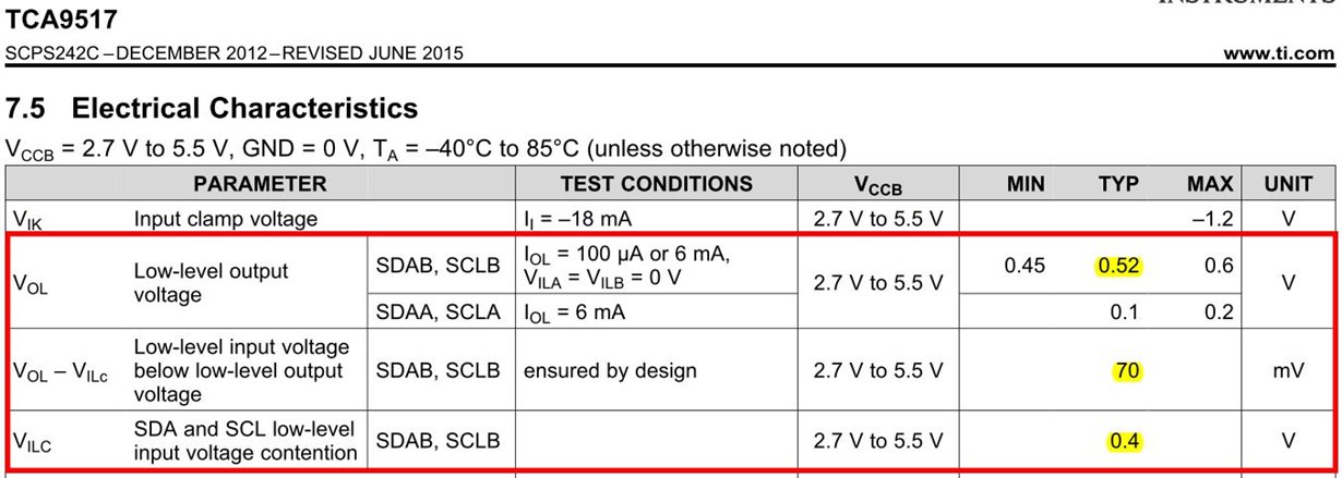

Hi Team,
I see similar posts, however, please allow me to post to clarify the TCA9517 requirement.
Below are the datasheet descriptions. Here, I have two questions.
Without the maximum value of VIL(B-side), customer would not be able to design system which operation is guaranteed.
[Q1]
What is the maximum VILC accepted for TCA9517 to avoid bus contention ?
We need to clarify what is the guaranteed voltage so that customer system would not have any problem.
If VILC=0.4V is the MAX instead of TYP, please let us know.
However, VOL_MIN - (VOL-VILC_TYP) is 0.38V. Regarding this spec, I was thinking that required VILC may be lower than 0.4V.
[Q2]
Why is "VOL-VILC" spec stated for ? It is also confusing that calculation result is not matching. (0.52 - 0.070 != 0.40)
I believe it is described to let user know the lowest voltage what TCA9517 can operate without any problem.
However, we need the worst condition information.
Kawai

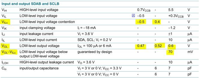

  • Hello Team,
    Below is competitor datasheet (NXP PCA9517). This is also not clear, however, MAXIMUM VOL-VILC is guaranteed as 70mV (MAX).
    Based on this number, one could understand that "MAX VILC = 0.40V". (Although the number is listed in the typ)
    Could you please tell us the MAX value for "VILC" or "VOL-VILC" ??
    Kawai

    I dug through all the simulation data I have for this part, and from what I can tell, VILC is typical 0.4 V. WE do not have a maximum, as it is bounded by the VOL of the device.
    I cannot find information on the VOL-VILC spec, however, based on some of the IP it shares from other devices, I believe it actually is 70 mV maximum, not typical. This would make the max VILC 0.6 V - 0.07 = 0.53 V depending on the VOL.

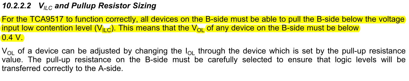

  • Hello Jonathan-san,
    Thank you for your reply. Please allow me to double check.
    Can you commit the TCA9517 will operate without any problem as long as customer designs "FPGA output VOL under 0.4V on B-side" ?
    I believe the worst VOL requirement from the device on B-side is the following.
    If VOL-VILC = 70mV (MAX),
    VILC (MAX) = VOL (MIN) - 70mV (MAX) = 0.450 - 0.070 = 0.38V
    So the CPU or FPGA on the B-side must have VOL lower than 0.38V.
    Regarding the answer VILC is 0.6V - 0.07 = 0.53V, so the VIL spec can be taken as it is relaxed.
    Kawai

  • Since the VILC value varies depending on the VOL of the device, you should go on the 'safe' side of it and do VOLmin- 70 mV = 0.45 - 0.07 = 0.38 V.
    0.38 V should be a safe max, because it's the lowest the VILC value might go, so it is the maximum that you should not cross to be safe.
    Thank you for your answer.
    I will answer customer to design VIL signal lower than 0.38V for safe operation.
