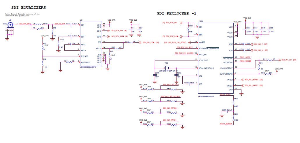

  • Hi Andres,
    In my application, the SDI camera will be far away from the board. So we are using equilizer and reclocker near to FPGA.Here reclocker is between FPGA and equalizer.
    SDI.pdf
    Please review my design and let me know any modifications required?
    Prasanna G
    In this Case which output should i use(SDO or SDO2) .
    Is there any benefit if i take outut from SDO2.
    Prasanna G
  • Hello Prasanna,
    After reviewing your schematic I found no problems with it.
    As for the SDO2 output, there is no benefit in using it over SDO other than the capability to use it as a reference clock for synchronization and/or debugging purposes.
