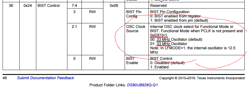

DS90UB928 will out put internal clock on loss of clock. The output seems configurable by 0x24 register, but in some points it is inconsistent.
1. Is setting of 0x03[1]=1 really necessary?
It looks irrelevant and pointing a wrong register.
2. Two options for the same frequency?
Both two options are 33MHz?

0x24
0x03[1]
    Can DS90UB928 really enable Auto Clock?
    The device outputs internal OSC clock when bit 5, 6, 7 of 0x02h configured 1. But when LOCK established, it stops CLKOUT. I could not find any configuration that the device automatically transitions to OSC clock.
    Please let me know how to configure the device to enable Auto Clock.
