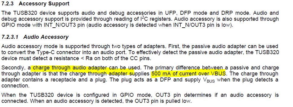

When connect 1.2KOhm to GND on both CC pin, TUSB320Lai should detect it as audio accessary. How about TUSB320LAI next action? Will it take ID pin low, and supply 500mA over VBUS? Based on our spec as below, it seems that should support passive audio adaptor or charger audio adaptor, what’s the difference? Customer hope when TUSB320LAI detect audio accessary, will not provide VBUS.

    Thanks a lot for your kindly help. According to TUSB320LAI datasheet, it seems that it can support 2 kinds of audio accessory, one is Passive Audio Adapter, and the other is Charge Through Audio Adapter. What's the difference for this two type while TUSB320LAI for recognition?
    Based on your explanation, my understanding is:
    1. For Passive Audio Adapter, the TUSB320 device must detect a resistance < Ra on both of the CC pins, but no power supply over VBUS. Then can read register 0x08, bit3-1 is 100, we can know that it's in Passive Audio Adapter. In this mode, ID pin will not drive LOW, and VBUS will also not provide power supply to external.  Right?
    Diego Cortes said:
    activate VBUS
    What' your meaning of "activate VBUS" ? in this mode, customer can also have VBUS provide power supply to external? How to activate VBUS?
    2. How about Charge Through Audio Adapter? TUSB320 device must detect a resistance < Ra on both of the CC pins, while also have power supply over VBUS? Then can read register 0x08, bit3-1 is 101?
    Would you please give a hand to description it more clearly? Thanks a lot.

  • Hello Lina,
        You are correct, the VBUS presence determines whether the audio accessory is active or passive. As I mentioned before, the TUSB320LAI notifies when an audio accessory has been connected by means of the status registers or OUT3, but please disregard my comment regarding to activate VBUS since it should be needed for passive audio accessories.
        Regarding your question about charge through audio adapter, your understanding is correct, the device must detect a resistance < Ra on both of the CC pins, while also have power supply over VBUS.
