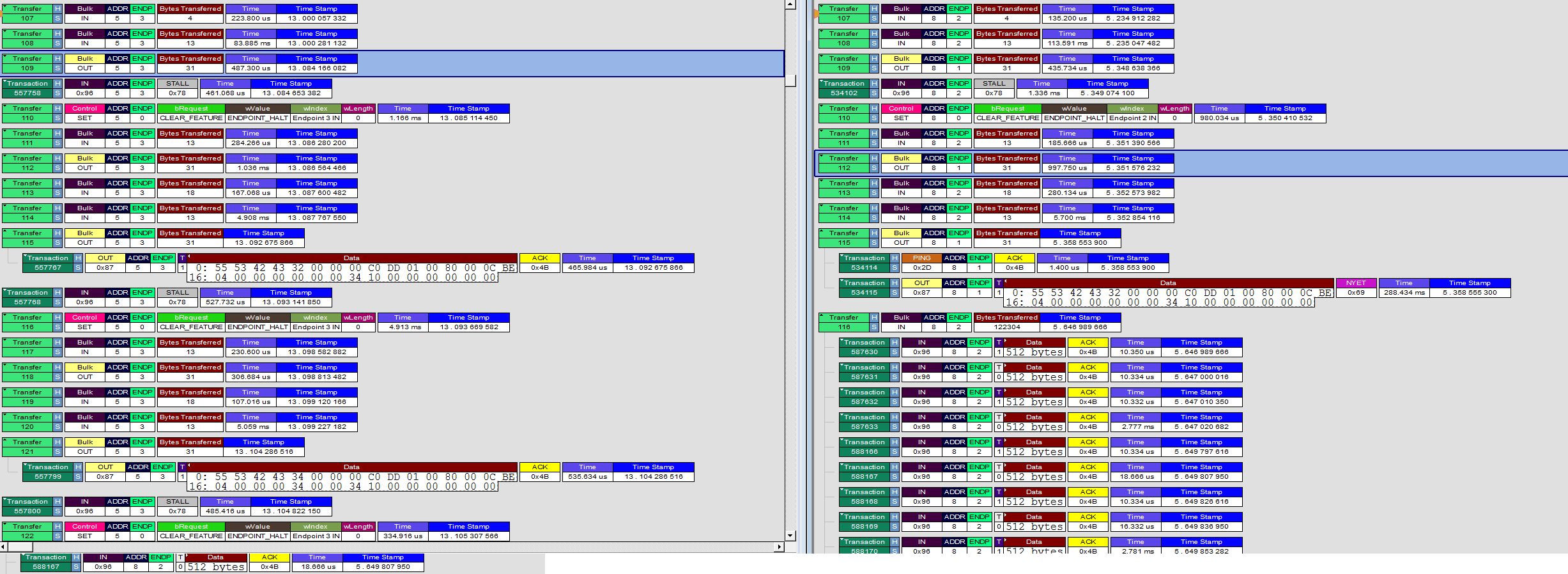

I am trying to use icedax to rid data from a CD player (actually a blueray player, but the media is a CD) connected to a linux box using the TUSB9261DEMO, and a sata to slim sata adapter.
Reading the TOC works fine, but reading the data fails, with this kind of messages:
Errno: 5 (Input/output error), ReadCD MMC 12 scsi sendcmd: cmd timeout after 0.002 (60) s
CDB: BE 04 00 00 00 00 00 00 34 10 00 00
resid: 122304
cmd finished after 0.002s timeout 60s
