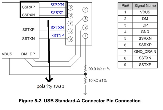

Dear Sir
May I know Atype connector pin5 can connect TUSB1310A's SSRXN and pin6 can connect TUSB1310A's SSRXP??
Polarity Swap ??
