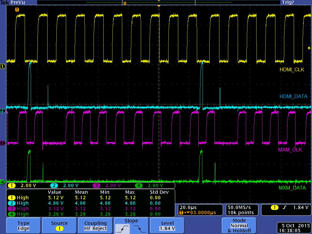

    I'm sorry if my previous answers haven't been so clear, DDC block just implements clock stretching , I'm attaching a capture from DP159.
    Purple signal is has a higher frequency, so DP159 has to stretch it, make it slower, then it generates another clock with slower frequency.
    If there is a level shifter in DDC, it may work as a DDC buffer too.

    The scope screen shows that the DDC block implements a byte-level clock stretching, not a bit-level one ("clock stretching" hears as an urban dictionary word when no context is specified). What about the timing parameters for that stretching? For how long time TMDS181 ties the SCL line low doing the stretching?
