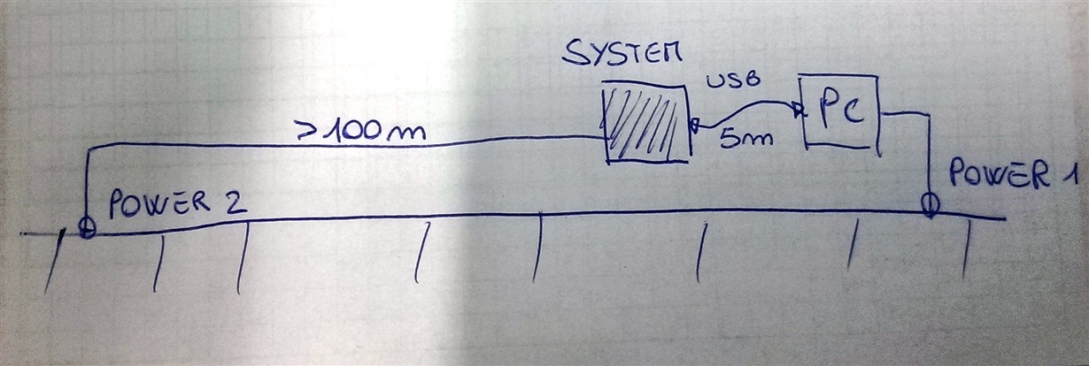

  • Hello Alec,
    actually the ground difference could be quite a lot since it's not about the 5 m length but the 100m or more power cable.
    Indeed the system gets the powered from point 2 while the PC from point 1 ( as shown in the system below).
    maybe this was not clear from previous description.
    TVS while may protect the system they will not allow the USB connection to work (if they will be activated).
    Thus, to keep the connection working also with a big ground difference, it might be better to have a separated USB controller and isolate the TX and RX lines. The power would also need to be isolated.
    SunSet
  • Hi SunSet,
    I think I understand the problem fully now.  What type of voltage gradient do you expect between Power 1 and Power 2 in an actual system?  Are these power rails going to be off of AC power, or a DC source?  If we're only talking a few hundred mV, then the system should work as-is.  To me, the best method would be a low resistance path between the 'System' and a ground near Power 1 via a ground strap or something similar.  That way the grounds should be well equalized and you wouldn't need to use isolation.  If the voltage delta is 1+ volts, isolation may be the best bet. Is it possible to just lift the ground connection on one of these two systems?  This would allow one of the two systems to reference itself to the other, and the current gradient across USB should be very small.
    Using a TVS diode wouldn't be any better than a hard ground connection, since ultimately you want the ground gradient from 'System' to 'PC' to be a little as possible.  Otherwise, you'll have violations of the common mode range on the USB transceivers and it won't work anyways.
  • Hello Jeff,
    the voltage difference could be up to several volts.
    Currently I'm proposing external USB controller so that they can isolate it from the main controller  via normal isolation barrier rather than isolating a differential lines. I don't think there is anything in the market for High Speed out of the box (there is something for Full speed).
    You are right, the Vcm would be out of spec, nevertheless the TVS would prevent the USB to work in any case.
