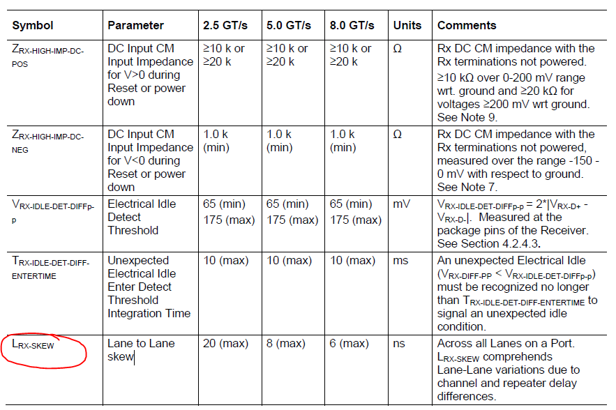

Do the pin package length is equal within IC die of DS80PCI800/810 for length matching concern ? if not, customer request the pin delay length at each lane. Thank you.

The information of length matching can be found in the datasheet as a skew specification. In the DS80PCI800 on p. 8, the typical lane-to-lane skew is 25 ps.
Please keep in mind that, from a system perspective, this skew is minimal, considering that for PCIe applications, the allowed lane-to-lane skew at the receiver of a PCIe system is on the scale of ns instead of ps.
