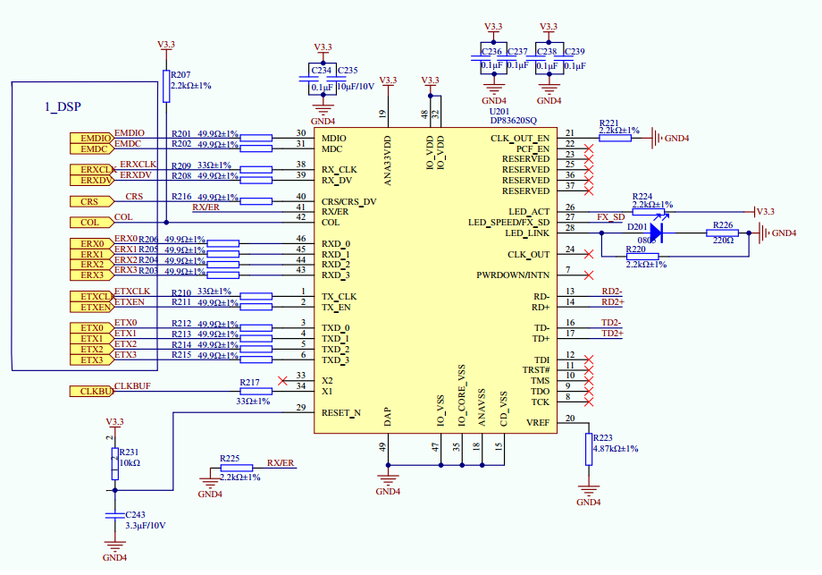

My customer do the EFT test on their power line. And they find the DP83620's register will change random which will casue the chip can't work.
After the software reset, the chip can become normal.
Could you tell me what will cause the internal register random change? Clock? Power?
    Can you tell me what registers are changing?
    Please let me know what the value you expect and then what you are seeing.
    The device will automatically configure the registers based on the bootstrap pin states. When the values in the registers are changing is the device being reset or going through a power-cycle?
    Please also note that the MDIO requires a pull-up resistor. I do not see this in your schematic.

    Below is the register changing:
              BMCR:Chaneg from 0x2000 to 0x0000;
    PHYIDR1:from 0x2000 to 0x0000;
    ANAR:from 0x101 to 0x0000;
    09h reserved register will also change from 0x2001 to 0x0000;
    PHYSTS:from 0x601to  0x6f1 or 0xe01 random change.
    MICR:from 0x0001to 0x0000;
    MISR:From 0x0000 to 0x200 or 0x2f0
    FCSCR:Always change
    RECR:From 0x0000 to 0x0001,0x0002 or 0x0000
    After EFT, all the register will become default value.
    The resgister change is due to EFT, the EFT will influence the internal register.
    I will check the PULL up register at MDIO pin. Will feedabck to you later.

  • Hi Ross:
    I have checked with them, the pull up resisitor is on the other schematic. So it should not the pull-up issue.
  • Hi Derek,
    What EFT testing is being done? Is this to a standard like IEC 61000-4-4?
    If the PHYID register is changing to 0x0000, then the PHY might be in an undefined state. A properly functioning DP836x0 will always respond with 0x2000 to the PHYID register.
