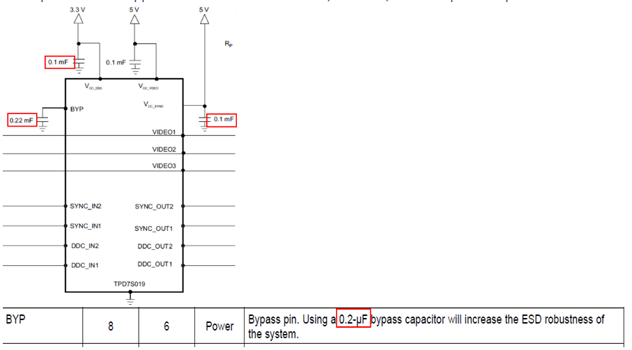

For the T/TPD7S019-15RSVR, please help to check the capacitor on the application  schematic are correct or not.
The capacitor on the application schematic are mF level, However, the description for pin BYP mentioned should use uF level capacitor.
  • Jim-
    Thanks for noticing that, sorry that our datasheet isn't accurate on the drawing! All of the millifarad measurements in the application drawing should actually be microfarads, so please take that into account while designing your system. I'll work over the next few days with our documentation team to get this fixed!
