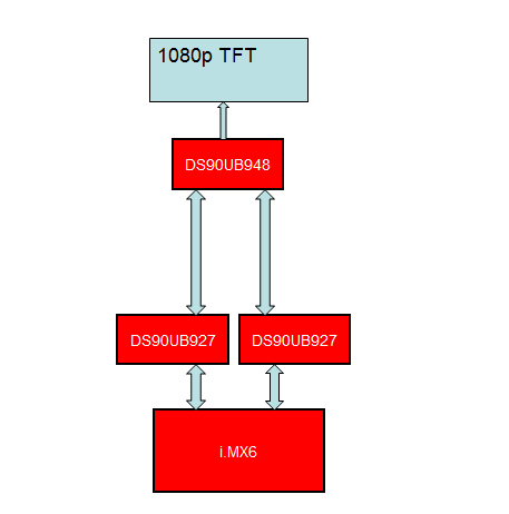

Based on i.MX6 infotainment application, one question when use 2pcs DS90UB927 connect to 1 pcs DS90UB948
Hello
Our Infotainment application is based on Freescale's i.MX6,we want to drive 1080P TFT.
Because DS90UB948 only have one CLK input,and i.MX6 have two CLK output,so we plan to use two DS90UB927 connect to DS90UB948,pls help tell us if there is any problem?
If this way is OK,do you konw some success story like this way?Thanks for help.
Pls refer to the pic as below:
