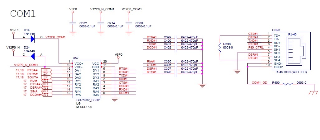

Dear Sir
We got some fail GD75232 IC from customer side
I saw the datasheet have sequence requirement in the old datasheet ,but in the latest datasheet ,there is no describe any timing delay for the sequence ,could you kindly help to confirm which timing sequence is right??
