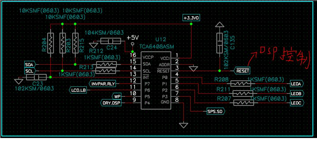

Hi Sir
May we check VCCP/VCCI need add capacitor?
And my customer find the TCA6408 easy to hang. may something we need notice?
                                                   Bogey
  • Hello Chen,
    It is recommended in the datasheet that decoupling capacitors be used on the supply.
    It is typically recommended that 2 decoupling caps be used per supply pin. These values are normally 1 uF and 0.1 uF.
    In regards to "easy to hang" post, I will require more information on the failure you are seeing in order to help you debug it.
