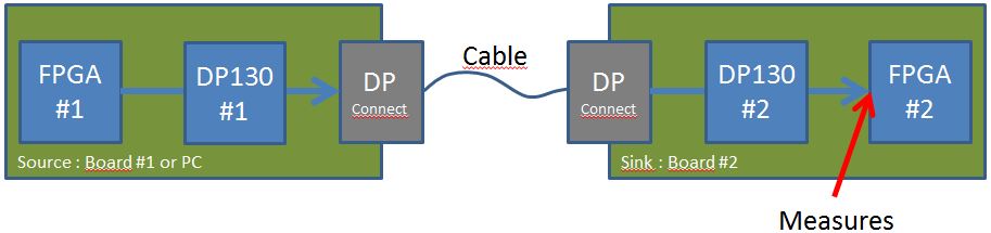

    The source is an FPGA with an SN75DP130 driver. The cables used are 3 and 7 meters lenght and 2 quality of cable for 7 meters.
    There is an SN75DP130 used as EQ before the FPGA Sink.
    Note that the 7mBlack cable works only if i disable the squelch feature.
    I have plan to optimize CTLE of the FPGA receivers on next week.

  • Hi Moises,
    The probes are fixed at the sink FPGA. See the diagram bellow :
    Also, you can see attached the DP schematic parts.
    Regards, Olivier
  • Hi Rollin,
    This is a public forum, I have downloaded and removed your schematic from the previous post.
    I have reviewed the schematic since it works you may leave it as is, but I have a couple comments:
    The AC capacitors close to J2 connector are not needed because there are AC caps in DP130 #1
    DP130 #2 is not following the application note for sink applications.
    DP130 monitors AUX channel to configure itself, having two DP130 in cascade will give some problems with this link training.
    Please configure both DP130 by I2C, disabling link training to get better results.
    You can set the highest Vod with the highest supported PE in DP130 #1
    Disable Squelch on DP130 #2
    Select the right EQ on DP130 #2.
  • Hi Moises,
    Ok for the caps, I already replaced them by 0Ohm resistor.
    Note that the DP source can be either FPGA#1+DP130#1 or another source like computer. And also the couple FPGA#1+DP130#1 can be used with displays.
    So i prefer to keep DP130#1 with link Training enabled, that's works well like that with all displays and all cables i have.
    Regarding the Sink (DP130#2), when i disabled the squelch, the link training works well over 7 or 10m of cable, the FPGA is clock recovered and symbol locked but the video status of the DP IP is unlocked, that's mean there some errors. The EQ on DP130#2 need to be adjusted for this specific case (actually the setting is 6dB/13dB). I note also that to much AC_Gain is not good for shorter cable.
    I have received the SN65DP141 eval board. Do you think is a better chip for this application?
    Olivier
