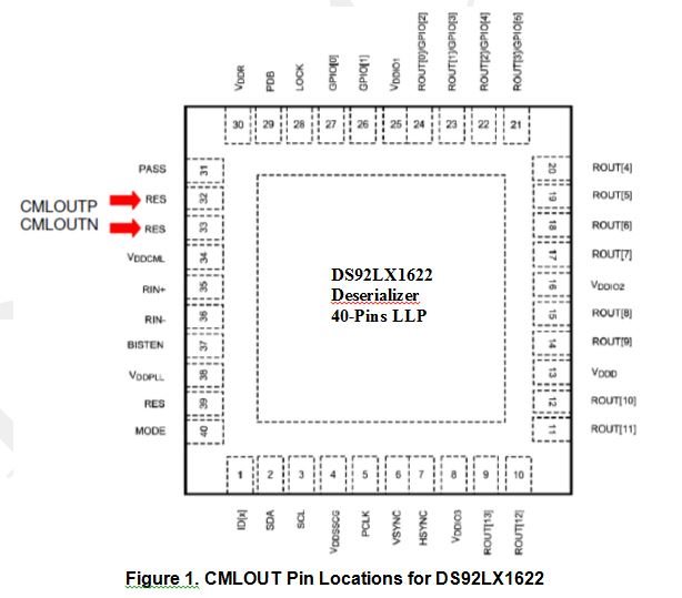

Q1. Can you let me know how to access the input signal quality on DS92LX1622 high speed input?

    1. There is a way to access the inputs after the EQ of the DS92LX1622 using Pin 32 (CMLOUTP) and Pin 33 (CMLOUTN):
    To enable the CML output for these pins, perform the following steps:
    • Use the true clock source of the application to trigger the scope. Normally, this is the transmit pixel clock of the transmitter.
    • Enable CML Output by setting Register 0x3F[4] = 0
    • Notes:
      • Do not enable CML Output during normal operation(0x3F[4] = 1)
      • Do not enable SSC during this measurement
    • For general purpose 100 Ohm STP cables, Reg 0x27 = 0xE0 provides the most margin.

    3. If you use the procedure shown above to enable the CML output, then you can see the effect of the CML output after the EQ:
    4. Unfortunately, we do not have an IBIS-AMI model or other representative model we can provide for the high-speed channel. I advise using the method shown in the answer to Question 1 to view the output after the EQ.
    5. The best way to observe the PLL bandwidth of the DS92LX1622 is to reference Figure 23 in the datasheet. The jitter tolerance curve roll-off at higher frequencies shows the approximate frequency limit of the PLL bandwidth, beyond which the PLL will attenuate jitter and can lose lock if the jitter at these higher frequencies are beyond the allowed jitter amplitude.
