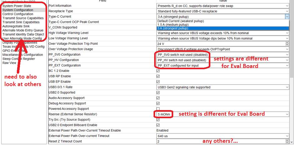

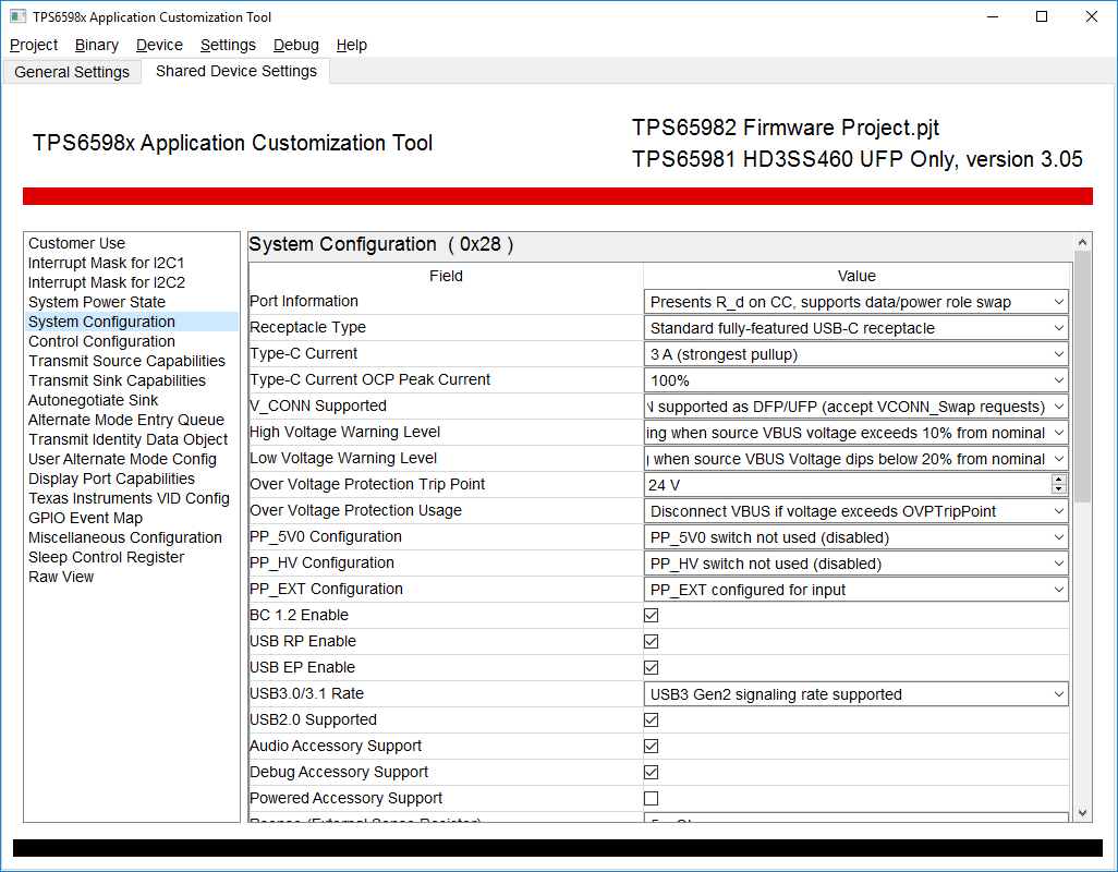

Do you have a template project file for the eval board? There are a myriad of differences between the stock and EVM settings. For example, this is just one page:
I can query each register but that is really tedious and time consuming. I would like to get the exact settings that were build for the EVM. Would you be able to provide that?
Hi Eric,
Exactly - I am looking for the "lookup table" that converts the DIP switch setting to the template filename. Right now it just gives me a description and so do the templates in the configuration software. Could you please provide me with that lookup table?
