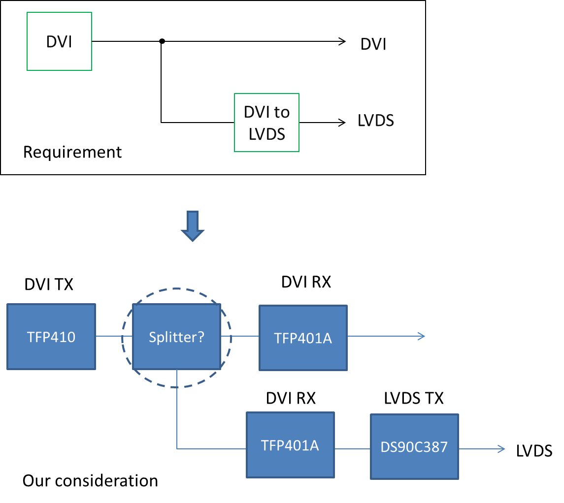

We are just considering how to realize the following requirement.
1. For the requirement, is our consideration reasonable? Do you have idea for more simple implementation?
2. Do you have recommended splitter?
BestRegards
    We don't have splitters, I can recommend you the TMDS442 which can output one signal at a time or duplicate the input signal on the two outputs.
    I don't have a better solution, yours looks good.
    Do you need the signal going to both DVI and LVDS at the same time?
