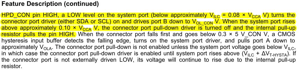

Can you advise me on signal dip on SCL_CON, SDA_CON and CEC_CON.
When Sink device is connected and HPD_CON changed Low to High, SCL_CON, SDA_CON and CEC_CON
Showed dip about 400 ns after the HPD assertion with about 200 ns duration.
_________________________
HPD _______________|
~400ns ~200 ns
________________ ________________
SCL_CON |_/
Is this expected symptom?
I suspect that the Level shifter block in the device may influence to this symptom.
I wonder if you can explain me the behavior of this block?
