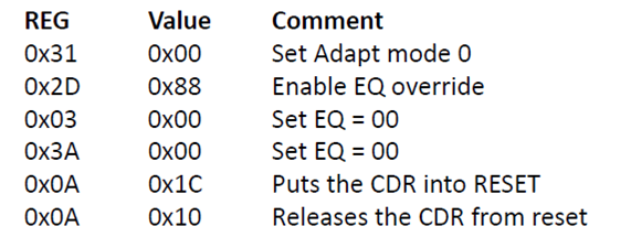

  • Hi Érico,
    There isn't a particular sequence that is needed for the register settings we have discussed so far.
    Could you try using adapt mode 0 and forcing zero boost with the rest of the settings default while monitoring 0x02?
    Instructions below:
    Dan
  • Hi Dan,
    I applied those configurations as you suggested, and monitor the CDR status as follow:
    CDR Status, channel 0:
      PPM_Count_met            = 0
      Auto_Adapt_Complete  = 0
      Fail_Lock_Check           = 0

    The CDR status is intermittent.
    Any opinion of this behaviour?
