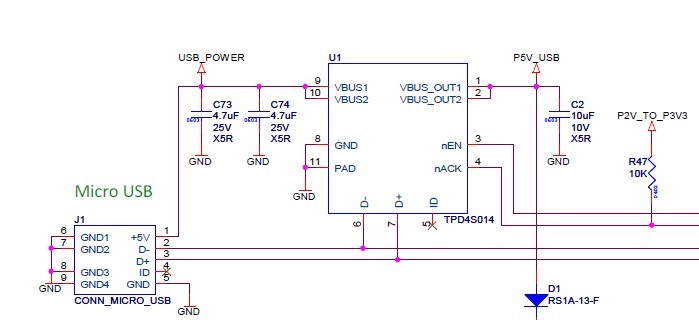

TPD4S014DSQR - ACK rebound after about 1 second
We are using the TPD4S014DSQR for USB protection (voltage and ESD).
On some boards (1/2), we have an abnormal comportement of the ACK pin (pin 4).
When USB power is disconnected, the nACK is driven high by the pull-up.

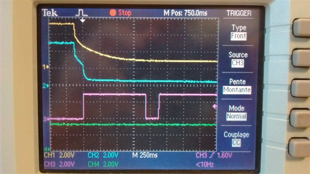

But the problem is after about 1 second the TPD4S014DSQR nACK is driven low for 250mS.
We have disconnected the MCU input on the nACK net.
CH1: USB_POWER
CH2: P5V_USB
CH3: nACK
CH4: P2V_TO_P3V3

    Looking at this, its not immediately obvious what would be causing this behavior on the ACK pin.
    Is it correct that on your 2 boards, this occurs on only one of them? If that is case, are there any differences in the two boards schematic or layout that could possibly explain this?
    Are there any temperature overheating issues on this board? If the device goes into thermal protection mode, it asserts the ACK pin even in UVLO. Could you also check to make sure that there is no bounce on the EN pin of the device?
    Thanks for your patience, if you'll provide me with this information I can help diagnose this issue for you.

  • Alec,
    1/
    We have made 50 boards (first product) and the problem is on half of them. All boards are identical.
    A board where the problem is detected, the problem systematically appears.
    2/
    The problem systematically appears board cold or not. I have not paste the EN signal but it is completly stable to 0V.
    Problem: The bad bounce on the ACK (ACK driven to 0V) signals a correct input voltage. So it is not a temperature overheating detection.
